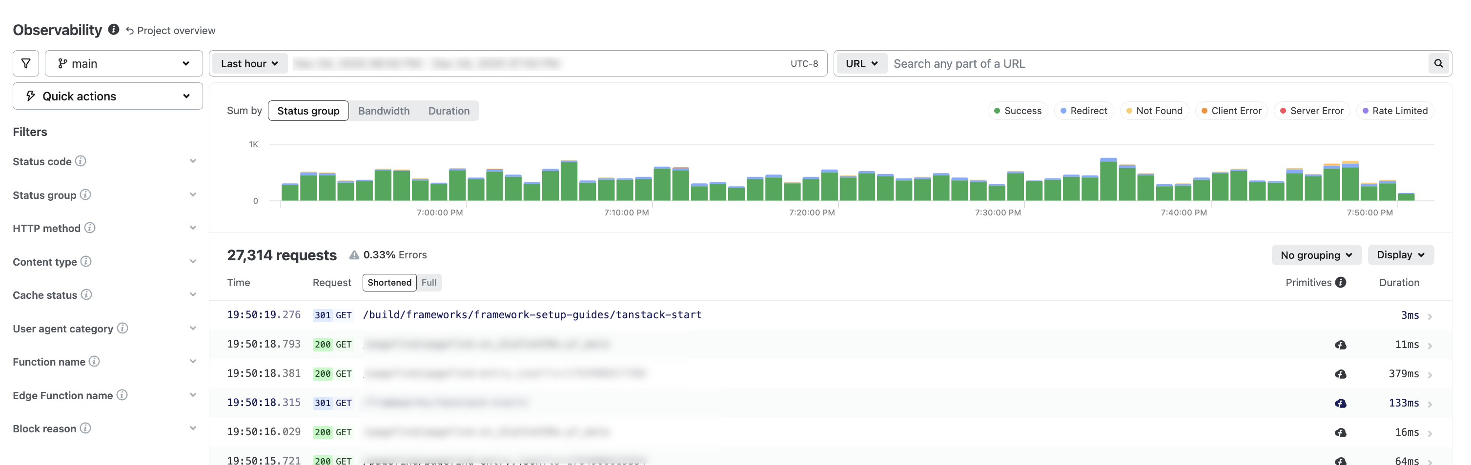

  • Observability is here
    Netlify Observability offers real-time visibility into your project’s production performance and resource usage.
    Monitor requests, bandwidth, runtime behavior, functions, and Edge Functions to understand how your web project operates in production, fix errors, and optimize web performance.
    Get a deep feature tour from our Observability blog post.
    Try Observability
    From your project overview, select Logs & metrics > Observability. To expand details for a request, select a request.
    Observability dashboard
    Availability
    Observability is available for Credit-based plans and Enterprise plans. If you have a Legacy pricing plan, you can get a sneak peek at your observability data by checking out the widget from your Project Overview.
    Observability widget on project overview showing past hour of request data
