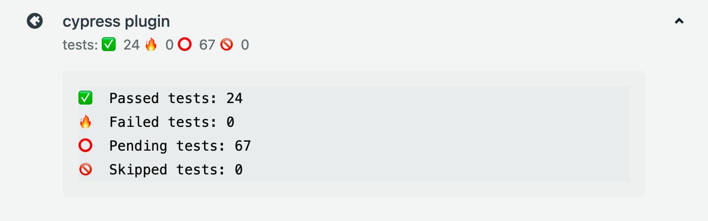

Displaying information in the deploy summary
Another property we have access to is utils. It lets us display some information in the deploy summary at the top of the deploy page, using utils.status.show.
We liked the way the existing Cypress build plugin showed information with icons, so we went with the same approach.
const summary = [
'tests:',
`✅ ${result.totalPassed}`,
`🔥 ${result.totalFailed}`,
`⭕️ ${result.totalPending}`,
`🚫 ${result.totalSkipped}`,
let text = `
✅ Passed tests: ${result.totalPassed}
🔥 Failed tests: ${result.totalFailed}
⭕️ Pending tests: ${result.totalPending}
🚫 Skipped tests: ${result.totalSkipped}
utils.status.show({
title: 'cypress plugin',
summary: summary.join(' '),
text,
