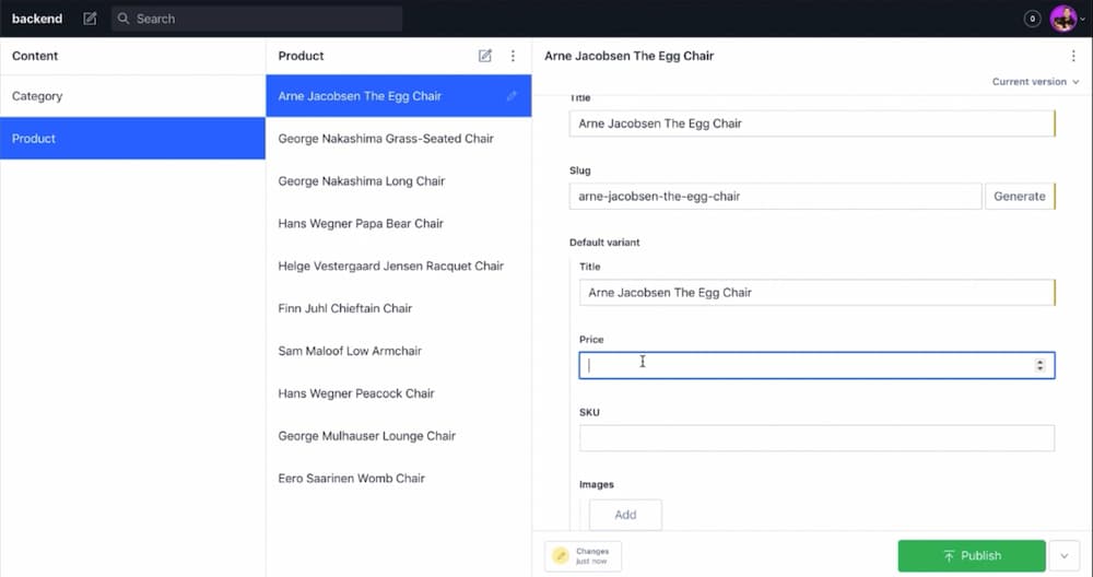

Does this work? Well, let’s add a new product and see about that. We can head back to our deployed Sanity.io instance. The address for this can be found at the top of the project dashboard beside ‘Studio’. Check out the section on Sanity deploying in the first part of this series to see where this link lives.
adding new data

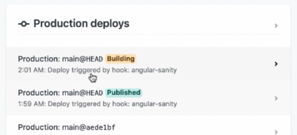

After hitting ‘Publish’ on the new data, we can look at the Netlify Production deploy logs (on the project’s main dashboard) and see that a build has been triggered by the Build Hook.
hook triggered
