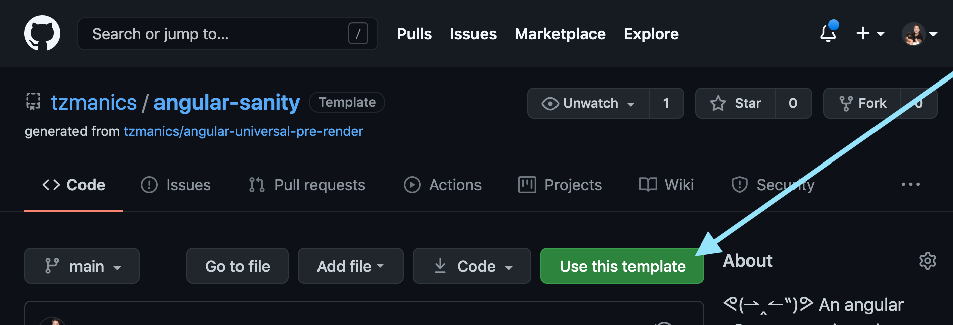

In order to jump into grabbing data as soon as we can, we’ll use a template project that uses Angular Universal to pre-render a few pages for us. The project can either be cloned locally from the command line:
git clone https://github.com/tzmanics/angular-sanity
Or we can click the ‘Use this template’ button from the repo’s homepage.

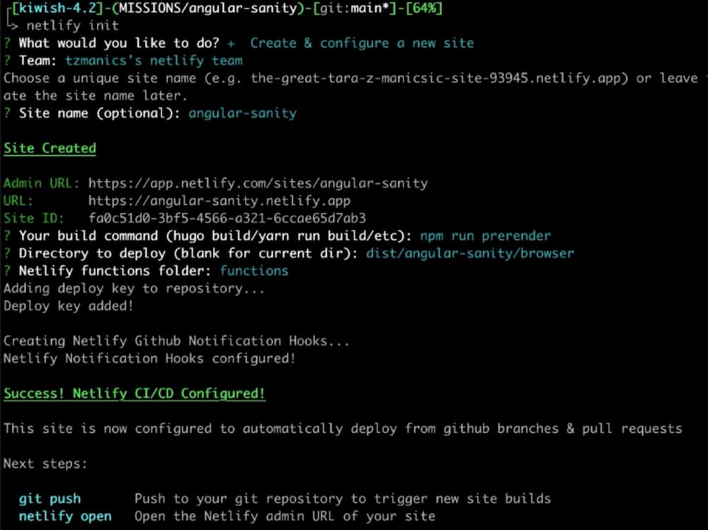

We can now hook this site up to Netlify so whenever we push a new commit it will trigger a new deploy (CI/CD). Having it live we can see what our users will experience when they request the site. The template project already has a Netlify configuration file, netlify.toml. We can just run a few commands using the Netlify CLI.
npm install netlify-cli -gnetlify loginnetlify initFirst, we install the Netlify CLI globally (if we don’t already have it installed) and log in (unless we’re already logged in). The netlify init command will ask a few questions and set the command and publish settings with the project’s netlify.toml file. This command will also trigger a deploy of the project. We can run netlify open to get to the project dashboard, to see when the build has been published.
Once this is set up, we can commit the changes we made when we changed this project name.
git add .git commit -m 'changes project name'git push --set-upstream mainThis push will also trigger a new build, so we’ll have the new information up on GitHub and live, yay!

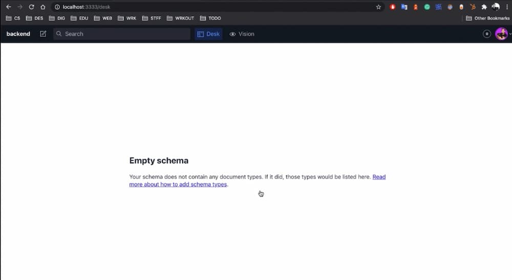

Change into the Sanity.io instance backend folder and run sanity start to start the UI up locally.
cd backendsanity startThen head to http://localhost:3333/ to see what we have to work with. It’s nothing. This is right because we haven’t added any schemas yet!

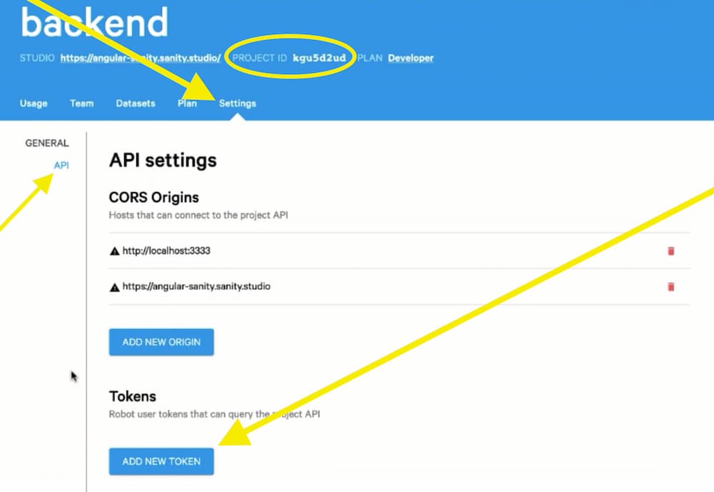

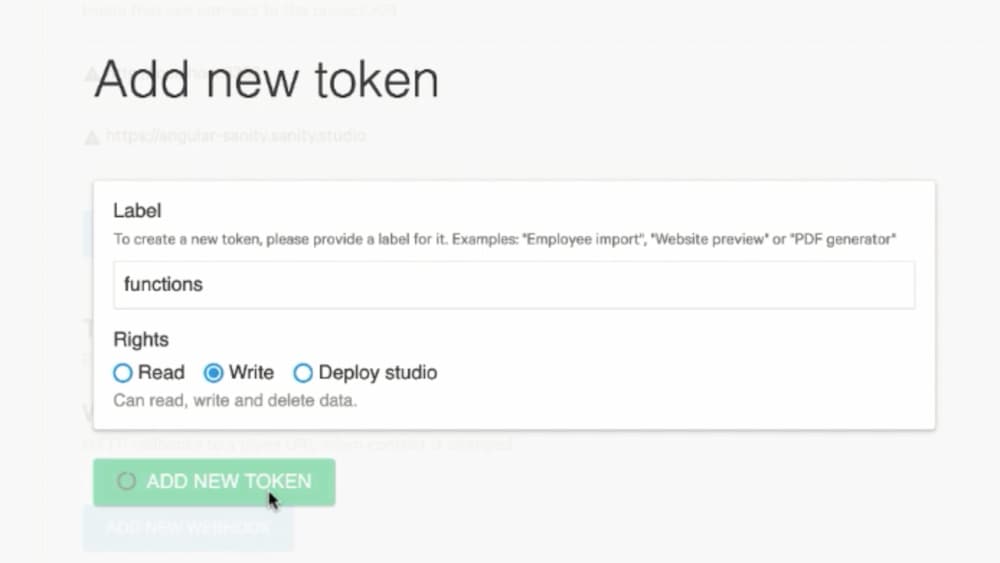

To connect to the CMS, we’ll need to use some project credentials: the project id, dataset, and a token. We can grab this information from the project’s dashboard. First, the project id is at the top of the page and we know we are using the ‘production’ data set. To get the Sanity.io token we’ll go to Settings/API/Tokens and click the ‘Add New Token’ button.
Then, we’ll name the token ‘functions’ and give it rights to write (which includes read, write, and delete data). When we click the ‘Add New Token’ button, we’ll get a token to copy.
Next, we’ll head back over to the project’s Netlify dashboard to enter these values. Go to Site settings/Build & deploy/Environment and click the Edit variables button. We will add the following variables:
SANITY_TOKEN= (the token we just created and copied)SANITY_DATASET= productionSANITY_PROJECT_ID= <your project id (e.g. kgu5d2ud)>

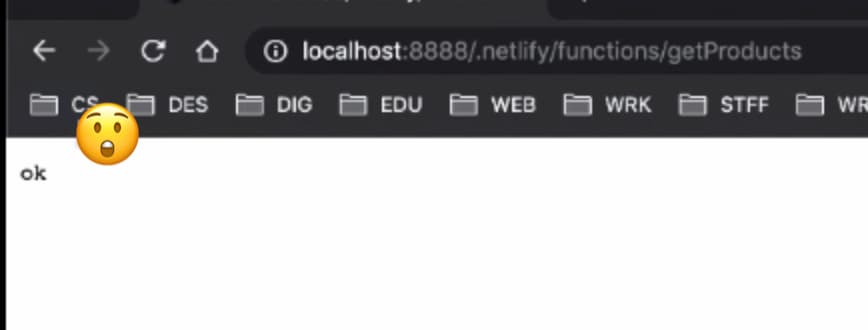

exports.handler = async () => { return { statusCode: 200. body: 'ok', };};Testing Locally
Through the Netlify CLI we can start up a local development environment by using the netlify dev command. Before we run that, let’s set local build settings for command and publish for the dev environment in the netlify.toml configuration file.
[build] command = "npm run prerender" functions = "./functions" publish = "dist/angular-sanity/browser"[dev] command = "npm run start" functions = "./functions" publish = "src"Now when we run netlify dev, we can head to http://localhost:8888/.netlify/functions/getProduct to see the output from the test function: ‘ok’. Riveting, I know.

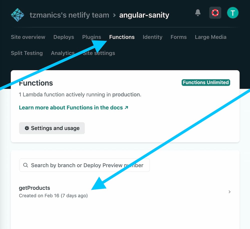

Once we have our function live, where do we find the logs? Netlify has a dedicated section for the functions to make them easy to keep track of and manage. From the project dashboard, there is a ‘Functions’ tab where we can see all the functions listed that the project uses.
To deploy the updated function we can git add, commit, and push the changes. The new build will be triggered and if we go to https://angular-sanity.netlify.app/.netlify/functions/getProducts we can see the output on the page and in our logs.
